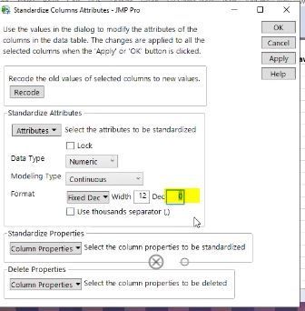

Q: What if I want fewer decimal places in my cell values?
A: The proportion values (percentages) must total 1 or your model will not work correctly.  Do not manually change the factor settings. Instead use Standardize Attributes and format the columns as Fixed Decimal with the appropriate number of decimal places.

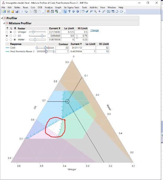

Q: Is the best/final solution "area" in the Ternary plot the white space, or the overlapped area (overlap of blue and green)?
A: White space is where you can meet your formulation objectives. JMP shades what does not meet the objectives.
