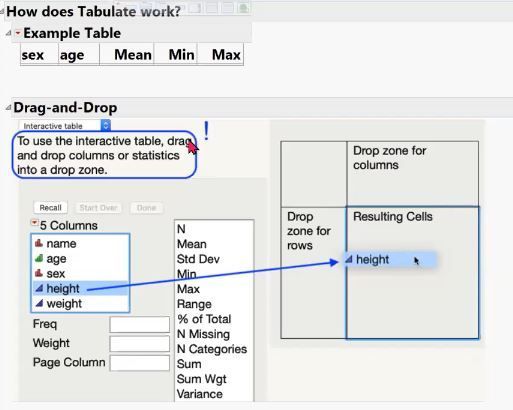

  • Understand the basic components of a tabulated table
    • Grouping columns: Nominal or Ordinal columns that together specify the groups we want to summarize
    • Analysis columns: Continuous columns for which we calculate summary statistics
    • Statistics: One or more statistics to calculate for you analysis column, within each group
  • Construct and save tabulated tables

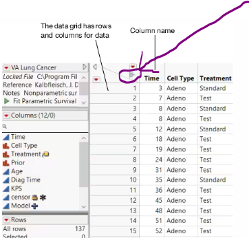

Q: How did you get the summaries under the column labels in the JMP table?
A: In JMP 15 or later you will see a grey horizontal histogram icon about the row name.  You can toggle this on and off to see counts. See below.

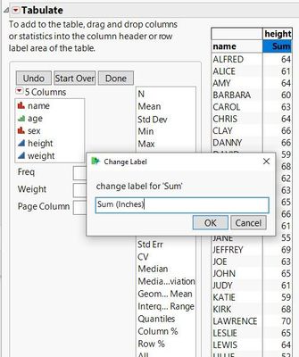

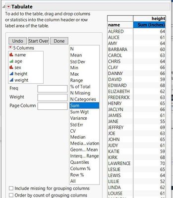

Q: Can you add the units (for example, inches) to the table?
A: The information is being pulled from the table. You might want to add units directly in the table name or change the  factor/column name (for example, Length (in inches).  Or you can change labels by R-clicking.

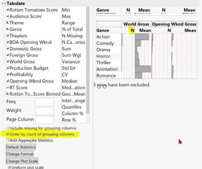

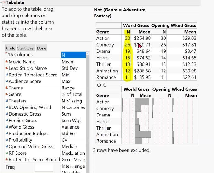

Q: Can you get tabulate to list by highest to lowest?
A: JMP is going to default to order alphabetically for categorical variables like NAME. So, the measurements (e.g., height and weight are going to be ordered by NAME). You can’t order by most statistics, and when you have a count column (N statistic), you can order by count.  See below.
Order by Count Step 1Order by Count Step 1Order by Count Step 1Order by Count Step 2Order by Count Step 2Order by Count Step 2
