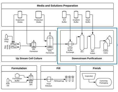

In this simulated pharmaceutical process emergency case study, see how teams to get alerts from JMP Live and, even in a remote location where they have VPN access ability, identify the root cause of the problem, put in place actions to address the problem, and share them with their team based on JMP Live authorizations.

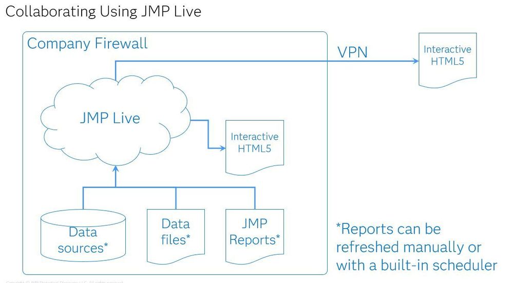

Q: Is this just basically HTML or Interactive HTML?
A: JMP Live gives you more than exporting to HTML reports, which are static.  JMP Live does use HTML as the main delivery structure for reports.  However, it goes 2 or 3 levels of complexity and sophistication beyond HTML. In JMP Live, you get full analysis interactivity. For example, you can use column switcher because it regenerates the graph.  If you apply a data filter, it goes back and recalculates everything and then regenerates the reports automatically. A JMP engine is running in the background. JMP Live also is more capable than saving reports as Interactive HTML with data, because the data can be updated automatically and integrated into a reporting system on JMP Live.
Q: Let's say that we have an AVEVA Solutions (formerly Wonderware) database accumulating process monitoring data and we want to query this data source to generate JMP tables for producing JMP Live reports. Referring to your diagram (showing the data source) can you trace how this data would work through the diagram using scheduled updates? Do these updates interrupt the HTML displays?
A: You are going to have some database historian (a Pi server or LIMS database, for example) that accumulates data.  JMP will query that and the query will be stored in a PostgreSQL database that's in the JMP Live instance.  JMP Live will make a direct copy of the data that is not editable . So, for pharmaceuticals, for example, you remain 21 CFR Part 11 compliant because your original data, your point of record, is somewhere else, not in JMP Live. JMP Live is working on a copy. After updates, reports refresh according to the schedule you determine.
