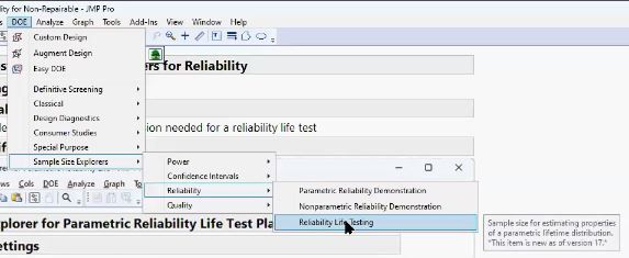

  • Use Sample Size Explorers to adjust study parameters and assumptions to explore different study designs to use for reliability life testing

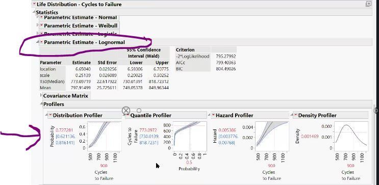

Q: When do we look at the profilers under Weibull?
A: When you are planning to use the Weibull distribution. The controls at the top of the report only apply to the graph. To use a profiler for a specific distribution, you need to use the fit under the appropriate outline box.
Profilers display under the section for each Distribution  type selected.  In this case, we  see  and can interact with Lognormal Profiler results.Profilers display under the section for each Distribution type selected. In this case, we see and can interact with Lognormal Profiler results.Profilers display under the section for each Distribution type selected. In this case, we see and can interact with Lognormal Profiler results.

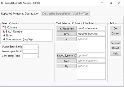

Q: How do we get to the Stability Studies analysis?
A: It’s under Degradation (Analyze>Reliability and Stability>Degradation), the third tab in the initial dialog.

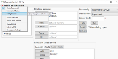

Q: Regarding Confidence Interval, I know JMP 16 can change the CI in the life distribution and in the Fit Life by X. Is there a way to change the CI in the Parametric survival fit? The default is 95%, some cases, I might want to change it to other values, for example, 75%.  I don't see this option in Fit Life by X.
A: In Fit Parametric Survival, you can change your Alpha level from the screen where you specify variables for analysis.  See the main red triangle.
