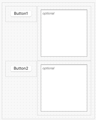

  7. Drag two Col List Boxes and two Button Boxes into the Lineup and arrange them two by two with each row getting a button followed by a Col List Box. The blue outline inside the Lineup shows where the object will be located. You can also put an object in a drop area if it exists. A data table must be open in the current application for the Filter Col Selector and Col List boxes to be available.Screenshot 2023-11-27 at 3.45.52 PM.pngScreenshot 2023-11-27 at 3.45.52 PM.png

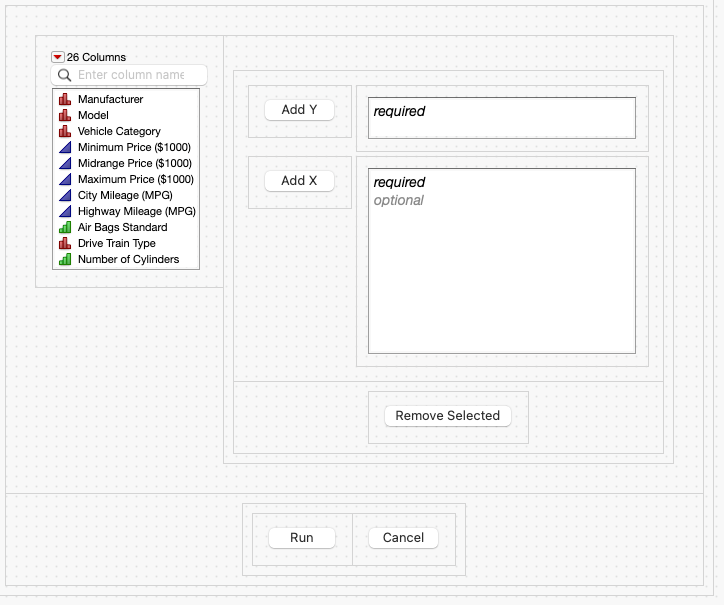

  22. Select the H Center Box and H List Box containing the other objects and add them to a V List Box.Screenshot 2023-11-27 at 3.56.54 PM.pngScreenshot 2023-11-27 at 3.56.54 PM.png
