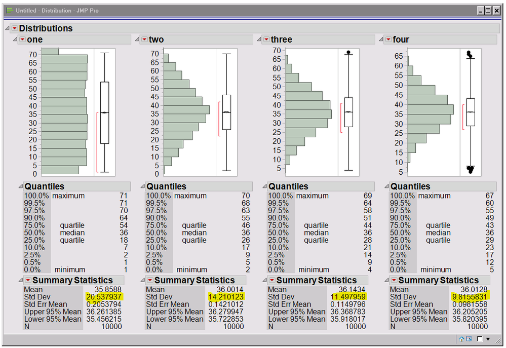

// make table and distributions. the number of dice
// and the number of sides is chosen to make the
// average roll be 36
dt = New Table( "Untitled",
    Add Rows( 10000 ),
    // each column has a formula that calls the function...
    New Column( "one", Formula( rollDice( 1, 71 ) ) ),
    New Column( "two", Formula( rollDice( 2, 35 ) ) ),
    New Column( "three", Formula( rollDice( 3, 23 ) ) ),
    New Column( "four", Formula( rollDice( 4, 17 ) ) )
// check the Std Dev in the 4 reports...
// it gets smaller with more dice
dt << Distribution(
    Continuous Distribution( Column( :one ) ),
    Continuous Distribution( Column( :two ) ),
    Continuous Distribution( Column( :three ) ),
    Continuous Distribution( Column( :four ) ),
    SendToReport(
        Dispatch( {"one"}, "Distrib Histogram", FrameBox, {DispatchSeg( Hist Seg( 1 ), Bin Span( 24, 0 ) )} ),
        Dispatch( {"two"}, "Distrib Histogram", FrameBox, {DispatchSeg( Hist Seg( 1 ), Bin Span( 24, 0 ) )} ),
        Dispatch( {"three"}, "Distrib Histogram", FrameBox, {DispatchSeg( Hist Seg( 1 ), Bin Span( 24, 0 ) )} ),
        Dispatch( {"four"}, "Distrib Histogram", FrameBox, {DispatchSeg( Hist Seg( 1 ), Bin Span( 24, 0 ) )} )
More dice, smaller standard deviationMore dice, smaller standard deviation
