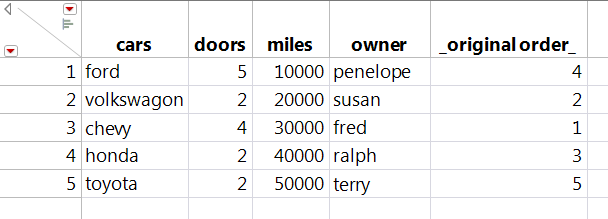

example:
cars = {chevy, volkswagon, honda, ford, toyota}; // list of unquoted names
doors = [4, 2, 2, 5, 2]; // matrix of numbers
miles = {30000, 20000, 40000, 10000, 50000}; // list of numbers
owner = {"fred", "susan", "ralph", "penelope", "terry"}; // list of quoted strings
zippedDt = zip( {cars, doors, miles, owner} );
zippedDt << sort( by( miles ), replacetable( 1 ) );
zippedDt << show Window; // table hidden by default
Lists are in table's columns, sorted by milesLists are in table's columns, sorted by miles
