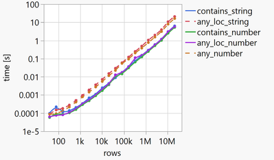

hogi
Ah, nice :)
I feared that contains is slower. but actually ...
note to myself: use contains  :)
View more...
Names Default To Here( 1 );
Try(close(dt, noSave));
results = New Table( "Untitled",
	Add Rows( 0 ),
	New Column( "rows" ),
	New Column( "t_contains_string" ),
	New Column( "t_any_loc_string" ),
	New Column( "t_contains_number" ),
	New Column( "t_any_loc_number" ),
	New Column( "t_any_number" )
dt << New Column( "nameID", Formula( Row() ) );
dt:nameID << delete formula;
For( i = 1, i <= 20, i++,
	t0 = HP Time();
	dt << Select Where( Contains( {"JANE", "DAVID", "PATTY"}, :name ) );
	t1 = ((HP Time() - t0) / 1000000);
	t0 = HP Time();
	dt << Select Where( Any( Loc( {"JANE", "DAVID", "PATTY"}, :name ) ) );
	t2 = ((HP Time() - t0) / 1000000);
	t0 = HP Time();
	dt << Select Where( Contains( {3, 15, 20}, :nameID ) );
	t3 = ((HP Time() - t0) / 1000000);
	t0 = HP Time();
	dt << Select Where( Any( Loc( [3 15 20], :nameID ) ) );
	t4 = ((HP Time() - t0) / 1000000);
	t0 = HP Time();
	dt << Select Where( Any( :nameID == [3 15 20] ) );
	t5 = ((HP Time() - t0) / 1000000);
	results << add rows( {:rows = N Rows( dt ),:t_contains_string = t1, :t_any_loc_string = t2, :t_contains_number = t3, :t_any_loc_number = t4, :t_any_number = t5} );
	dt = dt << concatenate( {dt}, Append to first table );
