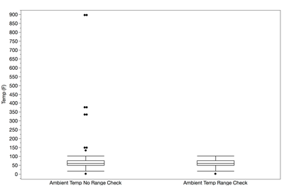

:Aeon Multisensor Ambient temp << Range Check(LELE(-30,120));
Discussion
Here is an example of why we want to do this as part of automatic data cleanup step. It is highly unlikely that the Ambient Temp recorded by this sensor is 900 degrees. The range check is an excellent way to automatically pre-process data and also provides a measure of sensor health. Since the range check changes values to missing, you can use the Explore Missing Values platform to see if maintence is required on your network or sensor (if the sensor is sending a lot of out of range values, they will manifest themselves as missing values).
