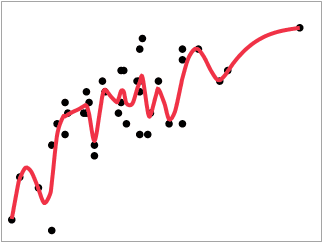

Discussion
Animated GIFs are suitable for small images and short durations. You can use other video editors to assemble bigger videos as AVI files. Sometimes you may need to re-run the platform with the new parameter. Above, the slider worked well, but setting the number field from JSL did not update the image.
Animated GIF changing spline tensionAnimated GIF changing spline tension
