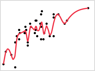

Discussion
Animated GIFs are suitable for small images and short durations. You can use other video editors to assemble bigger videos as AVI files. Sometimes you may need to re-run the platform with the new parameter. Above, the slider worked well, but setting the number field from JSL did not update the image.
Animated GIF changing spline tension
