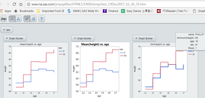

As a JMP HTML5 tester, what I often do is to generate a JMP report, and then export it to HTML5. However, I want to cover more testing cases for each exporting. For example, for step line chart testing, I want to see if HTML5 behaves correct for line connection types of Step, Centered Step, and other features.
Solution
I use new window to hold all reports. Simply insert JSL expressions into their place holders.

newwindow("test", outlinebox("test", Hlistbox(gb_expr1, gb_expr2, gb_expr3)));
