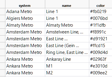

You have colors in the HTML format "#RRGGBB" and you want to use them in JMP graphs. For instance, here is the data set I used for the world metro stations scatter plot. The color column is a character column with six hexadecimal digits, two for each of the color components.
