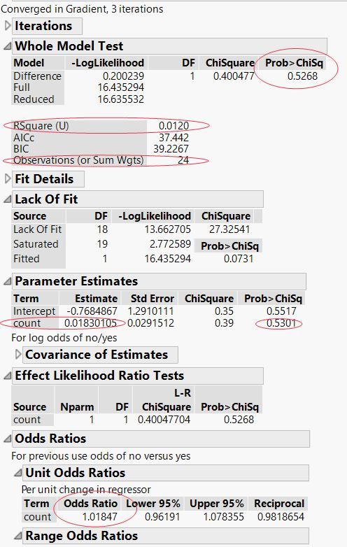

The final table I want is:
Attribute
Whole Model Test
RSquare (U)
N
Estimate
Prob>ChiSq
Odds Ratio
AUC
softness
1.000
0.000
24
0
1.000
1.000
0.500
count
0.5268
0.012
24
0.0183
0.5301
1.01847
0.5625
here is a screen shot of the report obtained in which I highlighted the data extracted.
(In attribute softness, for parameter estimate and odds ratio I took only the first row from the journal).
The original report window shows up but i didn't even get the additional report window to open.
Any tips would be appriciated.
TIA, Eli
