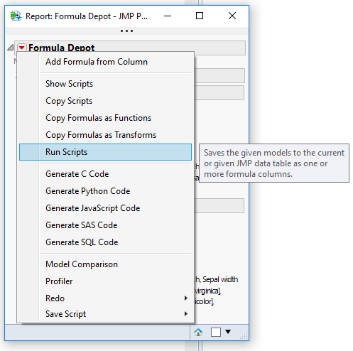

This functionality is directly supported by the Formula Depot, available in JMP Pro. Save your formulas from the table to the Depot using "Add Formula from Column", and later transfer them to a new table using "Run Scripts".
