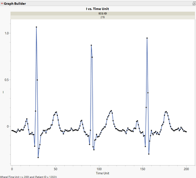

With the new JMP and Python integration tools, the only bottleneck in realizing my initial goal of just seeing the data was my lack of Python experience (I'd only dabbled in it just prior to joining JMP several years ago); using the Python tools for JMP was the easy part. In just one short afternoon, I was able to bang through all my Python coding errors to access the data and share the JMP visualization (also see video and attachments below). I might have even reached out directly to the developer (don't tell my boss) to express my gratitude.
