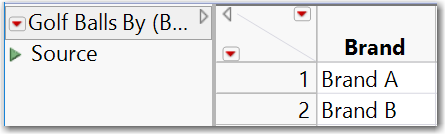

When a new data table is generated from a Tables command, the new data table has a table property called Source (see figure). The JSL code that generated the new data table from an original table is included in the Source table property. However, there are a few exceptions in which the code is either not captured or not that useful.
Source Table PropertySource Table Property
  • If you replace a table as a result of selecting Tables ► Sort, the code is not saved in the Source table property. If you want the code to be saved, do not replace the table when you do the sort. If you do not replace the table, the code is added to the new data table. You can copy and paste the code to another location, and add the option Replace Table.
  • If you select Tables ► Subset, the row numbers of the selected rows are included in the code. Having the row numbers is not very useful unless you want the same row numbers every time the code is run. Keep in mind that if you are writing a flexible script, you must select rows and columns before selecting Tables ► Subset. The commands that select portions of a data table are discussed in detail in Chapter 3, “Modifying and Combining Data Tables.”
