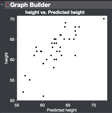

If you have other Julia packages installed, you can access them by Python import. Here I have used Pandas.jl, DataFrames.jl, and Lasso.jl to run a lasso fit for height on Big Class.jmp. Then I use JMP Graph Builder to plot the Actual vs. Predicted.
// Convert datatable to julia dataframe
// Must convert it to a julia Pandas dataframe first
dt = open("$SAMPLE_DATA/Big Class.jmp");
Pythonsend(dt);
Python Submit(
from julia import Pandas
from julia import DataFrames
from julia import Lasso
Main.dt = dt
predicted = Main.eval("""
using Lasso
df = DataFrames.DataFrame(Pandas.DataFrame(dt))
m = fit(LassoModel, @formula(height ~ sex + weight), df)
predict(m, df)
// Back to JMP where we plot Actual vs. Predicted
predicted = pythonget("predicted");
dt << newColumn("Predicted height", <<setValues(predicted));
dt << Graph Builder(
  Show Control Panel(0),
  Show Legend(0),
  Variables(X(:Predicted height), Y(:height)),
  Elements(Points(X, Y))
An actual vs. predicted Graph Builder plot with results calculated in Julia
