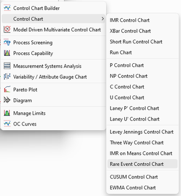

Choosing which control charts to publish to JMP Live
This one is easy – all of them can be published to JMP Live.
If you want the extra benefits on JMP Live, then simply opt to publish charts using the Control Chart Builder. Those charts consist of ones created directly from Control Chart Builder (obviously), as well as charts created from options under the Control Chart menu, ranging from IMR Control Chart all the way down to Rare Event Control Chart.

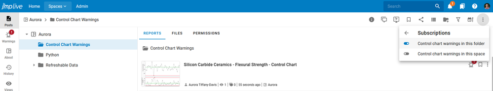

Getting notified about control chart warnings
JMP Live wants to notify the right people when warnings show up – and wants to avoid bothering everyone else. Opinions may vary on who exactly the right people are, but here is the list that JMP Live creates:
  1. The person who published the control chart report to JMP Live.
  2. People who are in a group that was set up to get these notifications (by an admin user).
  3. People who subscribed to receive notifications about warnings on:
    1. The JMP Live control chart report.
    2. The JMP Live folder.
    3. The entire JMP Live collaboration space.
Figure 2: Subscribing to receive warning notifications

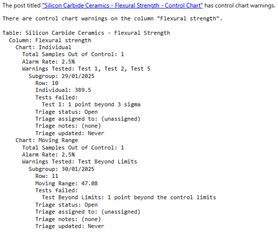

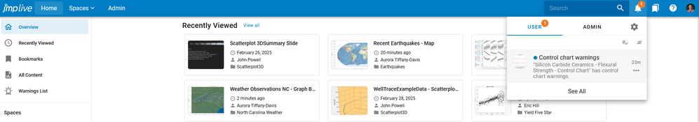

When JMP Live sends you a notification, you will see it when you visit JMP Live.
Figure 3: Onscreen warning notifications
You will also get an email notification.
Figure 4: Email warning notification

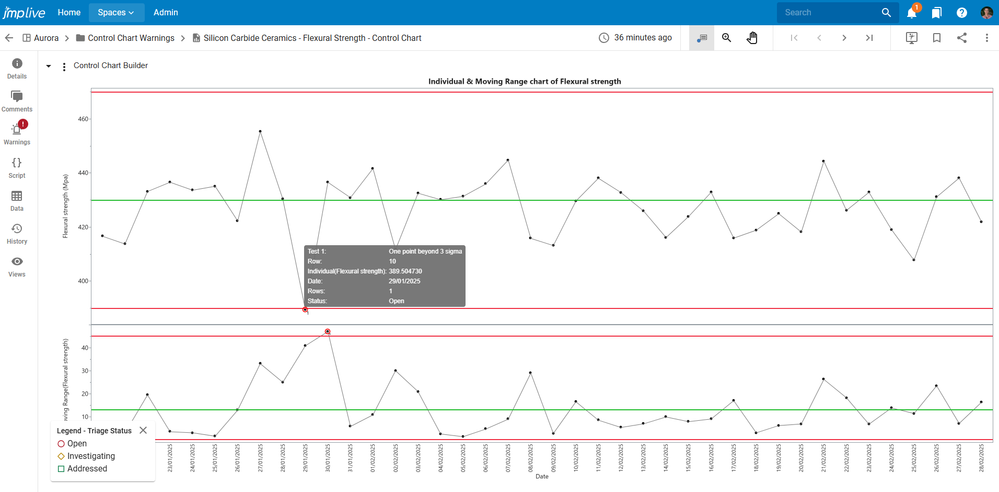

Here is a control chart report on JMP Live that has a few warnings. Hover over a warning to learn a little about it.
Figure 5: A control chart report on JMP Live

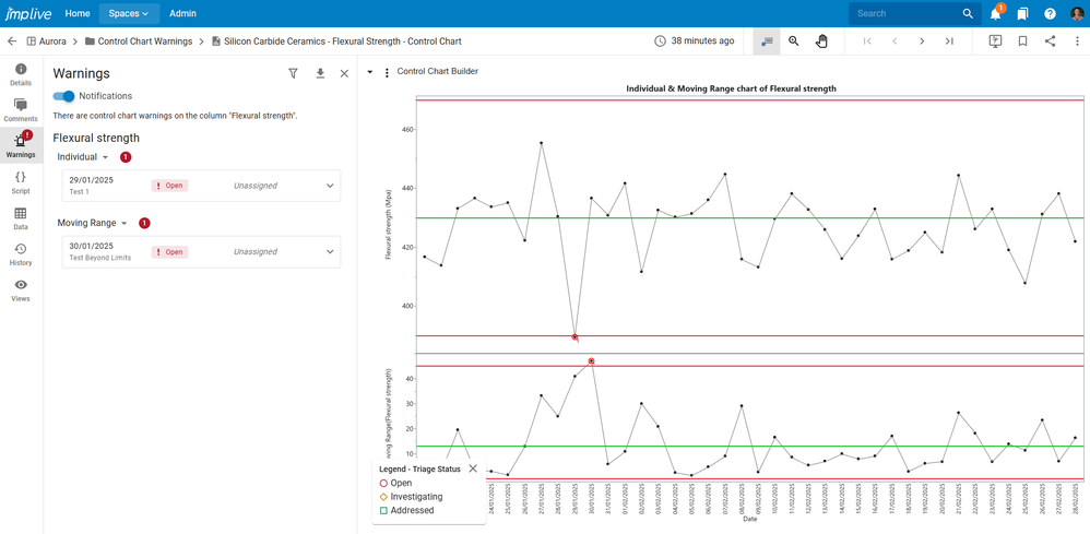

Open the Warnings Panel on the left to learn about all the warnings in the report.
Figure 6: A control chart report with Warnings panel opened

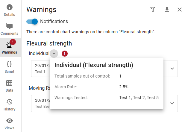

You can access summary information.
Figure 7: Warnings panel with summary information opened
You can access details about each of the warnings.

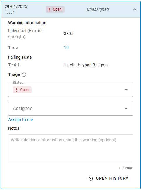

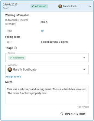

Let’s take a closer look at one of the warnings in the Warnings Panel list.
Figure 8: An individual warning opened in the Warnings panel
Under Triage, we have several fields.
Status answers the question, “Is this warning being dealt with?”
Once all of the warnings in a report have made it to Investigating or Addressed, JMP Live will take the hint that you’re on top of things, and will not send you another notification about warnings when the data is updated – unless of course new warnings pop up.

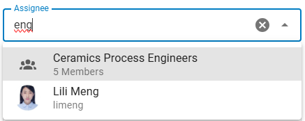

Assignee answers the question, “Who’s responsible for this warning?”
  • You can assign a warning to yourself with a single click.
  • You can assign a warning to another user or to a user group.
  • If you assign a warning to another user or to a user group, then they will receive a notification that contains a link directly to the specific warning of interest.
  • The user(s) that you assign a warning to do not need to have JMP on their machine to participate in the investigation and resolution of the warning. They don’t even need to know what JMP is. All they need is access to this report on your organization’s secure JMP Live site.

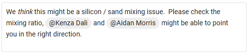

  • Notes can be any information you wish to retain about the warning, often answering the question, “What’s going on with this warning?”
  • If you mention a colleague in the notes, then they will receive a notification that contains a link directly to the specific warning of interest.

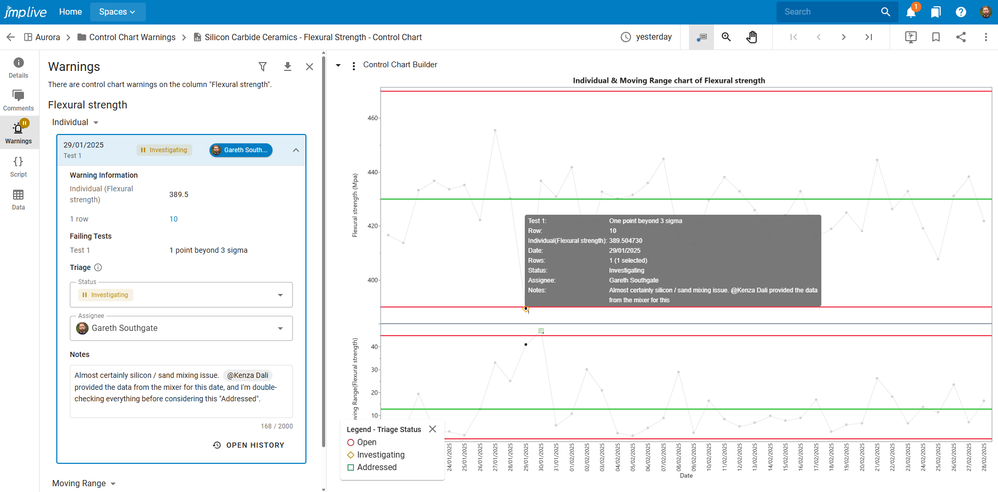

  • Triage a single warning by clicking on the warning in the chart itself, which will open it in the Warnings Panel list. You can then triage the warning as discussed above.

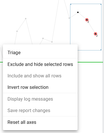

  • Triage multiple warnings by selecting multiple warning points in the chart: click and drag a box around the warnings, right-click, and choose Triage.
Figure 9: Selecting multiple warnings for triage
Once you and your coworkers start triaging warnings, anyone who sees the report on JMP Live can see what’s going on with the investigation and the resolution of the control chart warnings.

    • Each warning in the chart itself has an appearance that conveys the status.
    • See the Legend in the chart in the example below.
  • Details about the triage in the hover help for warnings on the chart itself.

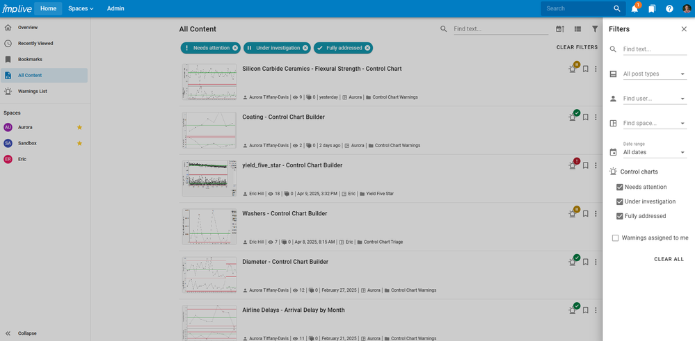

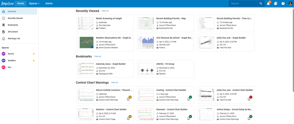

Anyone on the JMP Live Home page can see a list of reports that have control chart warnings.
Figure 11: Home page focus areas, including Control Chart Warnings section
Anyone looking at a list of reports on JMP Live (whether on the Home page or somewhere else) can see an icon showing the overall triage progress for each report. This icon is red for Needs Attention, yellow for Under Investigation, or green for Fully Addressed.  Users can also filter based on triage progress.
Figure 12: List of reports with triage progress indications and filtering

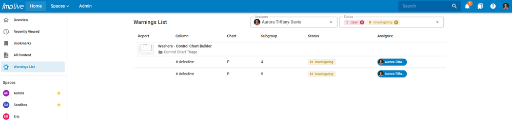

Monitoring the control chart triage work across the organization

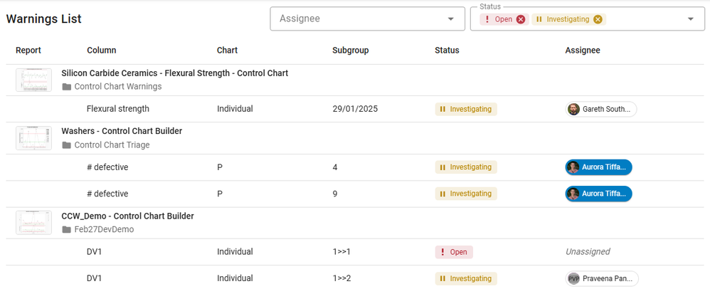

The Warnings List on the Home page is prefiltered by default to serve as your to-do list. It shows warnings assigned to you that are not yet addressed.
Figure 13: Warnings List with default filters applied

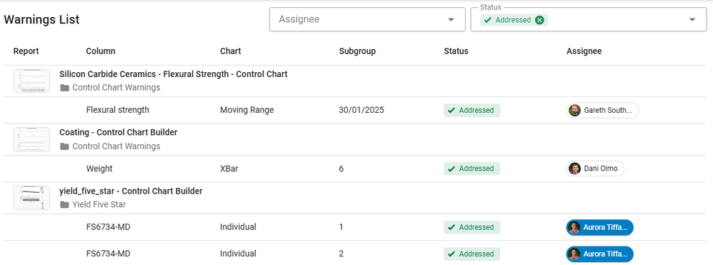

By changing these filter defaults, you can see a colleague’s to-do list, your whole organization’s to-do list, a list of warnings that have not been assigned yet – or a list of warnings that have been addressed (if you want to cheer yourself up).

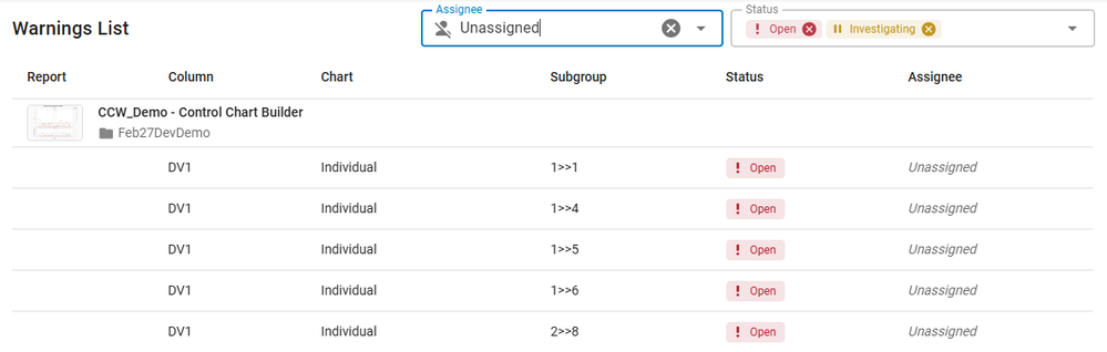

Figure 15: Warnings List filtered to all unaddressed warnings
Figure 16: Warnings List filtered to unassigned warnings
Figure 17: Warnings List filtered to addressed warnings

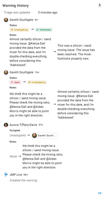

Reviewing the warnings in a report in detail
At times, you may need to review the history of a particular warning or the current state of all warnings in a report.
From a warning in a report’s Warnings Panel, the Open History button displays the entire history of triage decisions made for that warning. This entire history can also be downloaded as a *.csv file.
Figure 18: An individual warning opened in the Warnings Panel, with Open History button shown
Figure 19: Open History results for a single warning

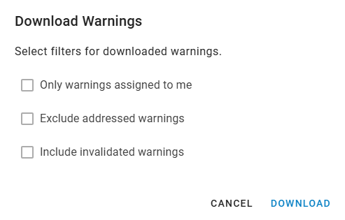

The current state of all warnings in a report can also be downloaded as a *.csv file, optionally with filtering applied.
Figure 20: Download warnings options
