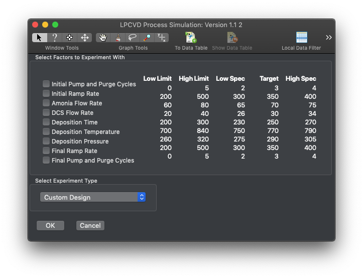

ENBIS Simulator DOE InterfaceENBIS Simulator DOE Interface
In the DOE simulator, we have control over a number of the process parameters and gas flow rates. The simulator gives data measured from 49 sites across the substrate arranged as a center point and three concentric rings of measurements. This measurement pattern is relatively standard in the industry. It’s not my favorite by a long shot, but it shows up a lot.
