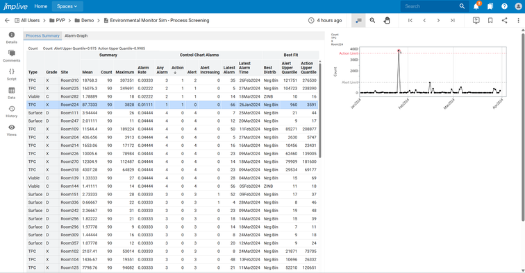

Interactive control charts for deeper insights
A standout feature is the ability to visualize control charts associated with each process directly from the summary table. Simply select a process, and its control chart appears – no extra steps required. Need to compare multiple processes? Select as many rows as you like in the summary table to view all relevant control charts side by side in the panel, enabling comprehensive, simultaneous analysis.
These control charts are fully interactive. Hover over any data point to instantly reveal detailed information, making it easy to investigate anomalies or trends at a granular level.

Introducing the count control chart
The new count control chart is perfect for analyzing frequency count data, such as the number of non-conformities in a unit. It is especially valuable in environmental monitoring, where counts might represent the presence of mold, bacteria, or other contaminants detected by sensors.
For this chart type, two key control limits are used:
  • Alert limits: Serve as early warnings when counts are elevated (typically set at the 0.975 quantile of the fitted distribution).
  • Action limits: Indicate when immediate remedial action is required (set at the 0.9985 quantile).
    Environmental MonitoringEnvironmental Monitoring
