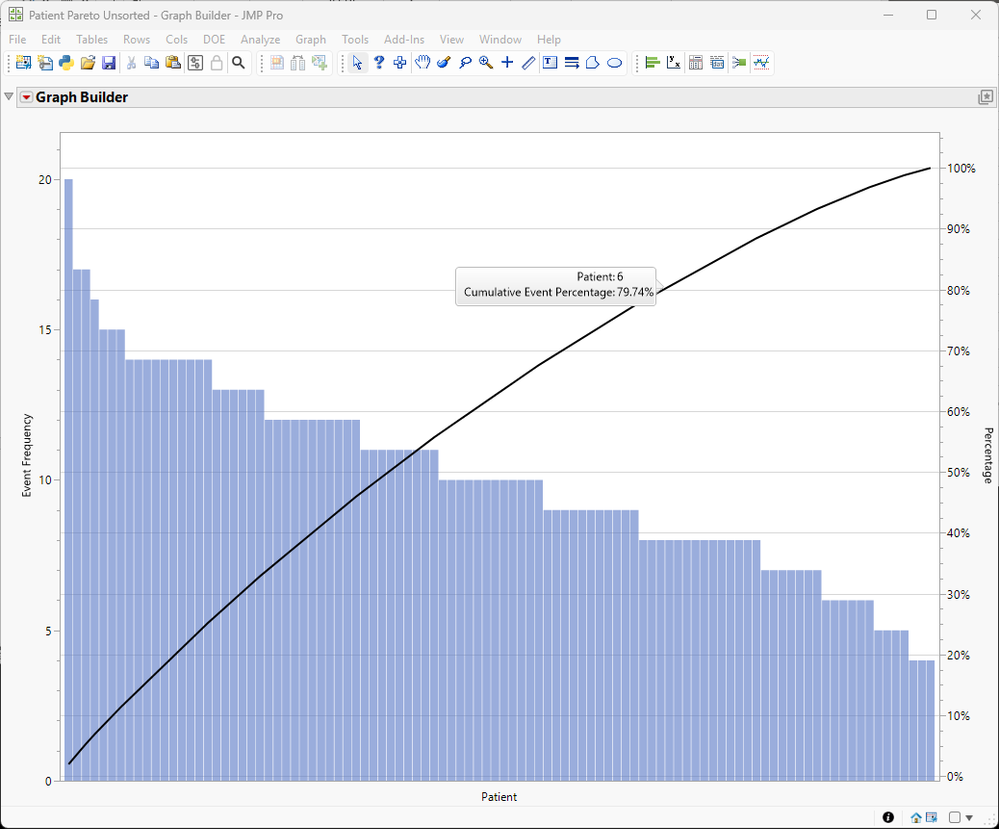

We can produce a Pareto-like plot of event frequency by patient (Figure 3).
Figure 3. Pareto plot of events by patient.Figure 3. Pareto plot of events by patient.
In Figure 3, the X axis represents patients sorted by the total number of events they experienced over the 10-day period in descending order; the Y axis is the total number of events experienced. The black line is the cumulative proportion of the total number of events experienced as we proceed from left to right in the plot. You can use the grid lines to find the percentage of interest (say, 80%) and hover over the black line to identify the patient for whom approximately 80% of the total number of events occurs. In the above, approximately 80% of events occurs at Patient 6. Figure 3 has some limitations:
  1. It does not describe the cumulative event frequency.
  2. It does not communicate the cumulative frequency or percentage of patients involved among the 80% of events.

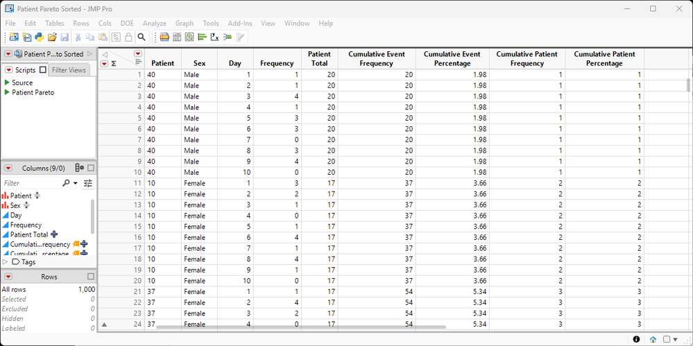

I can solve these problems, but it requires some additional work in the data table. Figure 6 presents the above data table with some additional variables defined, and sorted by Patient Total (descending), Patient, and Day.
Figure 6. Sorted simulated data of events.Figure 6. Sorted simulated data of events.
Why the extra steps?
  1. The Patient Total column allows me to sort the data table to produce the four cumulative frequency and percentage variables according to the order of the X axis needed for the plot
  2. Computing these variables in the data table (or alternatively within Graph Builder) allows me to label the rows according to these columns so that no matter where I hover, I will get a complete picture of cumulative events and patients.

I glossed over a brief point in the Figure 6 data table. These columns use several statistical column formulas, and as I mentioned above, I will describe this in detail in a future blog post. The important point to note, however, is that all of these calls use the Excluded option. This option is critical so that when a Data Filter is used to subset the patients, the cumulative variables update appropriately according to this smaller population. This step was not required for the Figure 2 data table, as Graph Builder handled those computations automatically.
