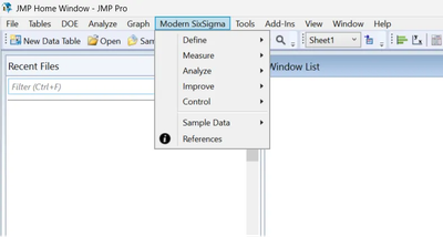

1. Modern Six Sigma: Your DMAIC command center
The Modern Six Sigma add-in serves as the foundation for a structured DMAIC workflow. It brings together JMP tools commonly used throughout Define, Measure, Analyze, Improve, and Control phases into a single convenient menu.
Rather than searching through multiple JMP menus, practitioners can quickly access tools for:
  • Project organization and documentation
  • Pareto analysis
  • Process capability studies
  • Measurement system analysis
  • Hypothesis testing
  • Design of experiments (DOE)
  • Control charts and SPC
The add-in acts as a roadmap for newer Six Sigma practitioners while helping experienced Black Belts and Green Belts work more efficiently.
One particularly valuable feature is its integration with other JMP Marketplace extensions, including Capability Explorer, creating a seamless workflow from problem identification through process control.

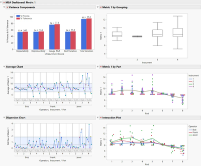

2. Measurement Systems Analysis Dashboard: Trust your measurements first
A common Six Sigma principle states:
“Before improving a process, ensure you can measure it correctly.”
Many failed improvement initiatives can be traced back to unreliable measurement systems rather than actual process variation.
The Measurement Systems Analysis Dashboard provides a quick and shareable view of Gauge R&R and measurement system analysis (MSA) results. Instead of navigating multiple reports, users can access key statistics and visualizations through a consolidated dashboard.
This extension helps teams answer critical questions such as:
  • Is the gauge repeatable?
  • Are operators introducing variation?
  • Is measurement variation masking process performance?
  • Can we trust the data used for decision making?
Because MSA findings are often shared with quality teams, auditors, suppliers, and regulatory stakeholders, the dashboard format improves communication and transparency while preserving the statistical rigor of JMP's measurement system analysis capabilities.

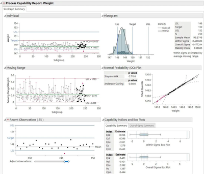

3. Capability Explorer: Process capability at a glance
Capability analysis is one of the most frequently used statistical tools in Six Sigma. Yet many organizations struggle to consolidate all relevant capability information into a single view.
The Capability Explorer extension addresses this challenge by creating an interactive six-graph summary for process capability evaluation.
The report combines:
  • Control charts
  • Histograms
  • Probability plots
  • Capability indices
  • Defect rate information
  • Box plots
The result is a single dashboard that provides an immediate understanding of process performance.
The extension also includes a Capability Comparison platform that allows users to compare performance before and after process improvements. It is particularly valuable during Improve and Control phases when teams want to quantify the effectiveness of corrective actions.
Instead of generating multiple reports and manually assembling results, practitioners gain an integrated and interactive capability assessment in minutes.

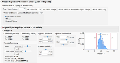

4. What-If Capability: Simulate improvement before spending resources
At some point, every Six Sigma team asks, “If we improve the process, how much improvement can we expect?”
The What-If Capability extension helps answer that question.
This interactive tool allows users to explore how changes in specification limits, process mean, and process variation affect Cpk and Ppk values, process capability metrics, and defect rates.
Instead of relying on assumptions, teams can visualize the impact of potential improvements before investing time, money, and resources.
For example:
  • Would reducing variability by 20% meaningfully improve yield?
  • How much centering is required to reach a target Cpk?
  • Is it better to improve precision or shift the mean?
These insights allow improvement teams to prioritize efforts with the highest expected return.
The result is more informed decision making and better alignment between statistical findings and business objectives.

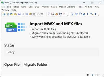

5. MWX MPX File Importer: Simplifying migration from minitab
Many organizations begin their quality journey using different statistical software. As they discover the interactive analytics and visual exploration capabilities of JMP, they often face one challenge: bringing their legacy projects to the new software.
The MWX MPX File Importer solves this problem by allowing users to import Minitab MWX worksheet files and Minitab MPX project files directly into JMP data tables.
This capability is especially useful for organizations transitioning from traditional Six Sigma toolsets to workflows in JMP.
Instead of recreating studies from scratch, users can:
  • Preserve historical project data.
  • Continue ongoing quality initiatives.
  • Accelerate migration efforts.
  • Reduce rework and validation effort.
For teams modernizing their analytics platforms, this extension helps ensure continuity while unlocking JMP's broader visualization and discovery capabilities.
