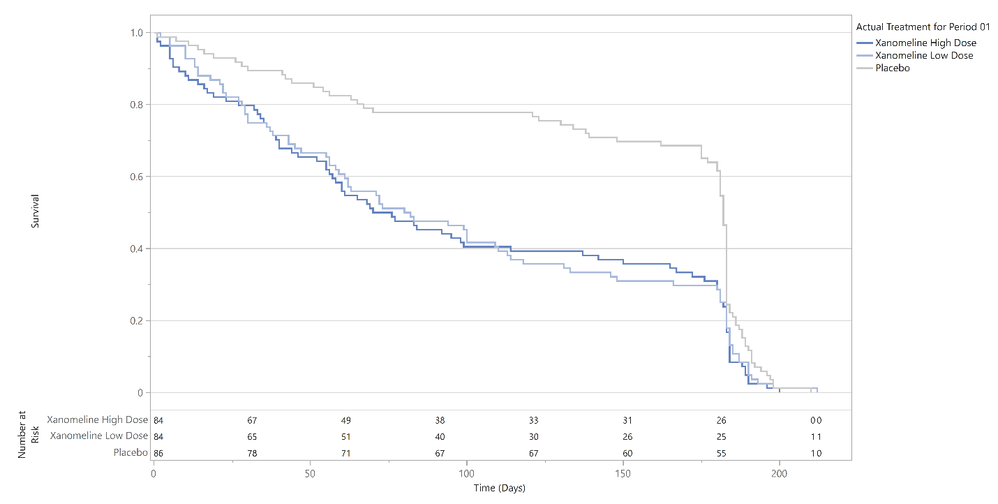

Figure 1 summarizes the duration of exposure using a Kaplan-Meier plot. The Time at Risk table at the bottom of the plot communicates the number of patients who have yet to complete their treatment. This table can be customized according to a user-defined interval, and the table can be modified to present the cumulative number of events, which, in this case, would be the number of individuals who completed their treatment by a given day.
Figure 1. Kaplan-Meier plot of duration of exposureFigure 1. Kaplan-Meier plot of duration of exposure

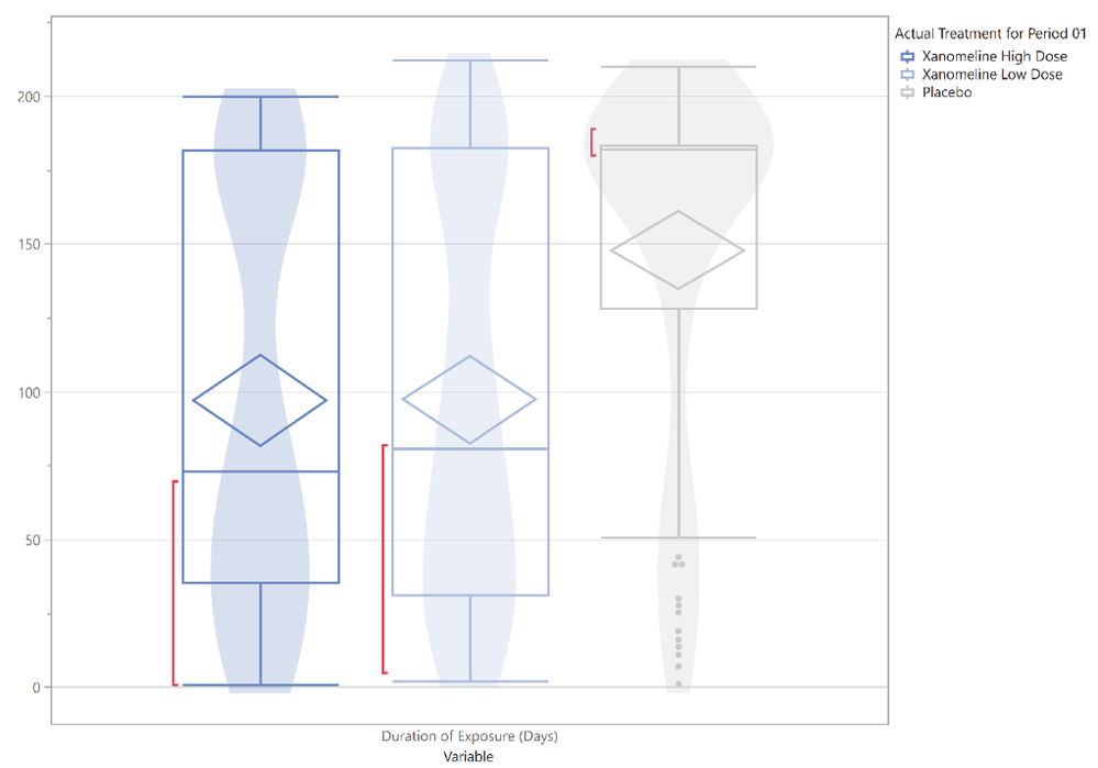

Figure 1 clearly communicates that placebo patients were more likely to complete their treatment compared to the active doses, suggesting a possible tolerability issue with the drug. Duration of exposure, as well as the other metrics listed above, can be further explored using box-violin plots to communicate key summary statistics and highlight potential outliers (Figure 2). The numeric details are summarized in a corresponding table (Figure 3).
Figure 2. Box-violin plots of duration of exposureFigure 2. Box-violin plots of duration of exposure

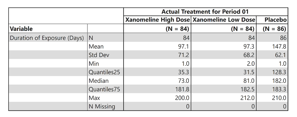

Figure 3. Summary statistics of duration of exposureFigure 3. Summary statistics of duration of exposure

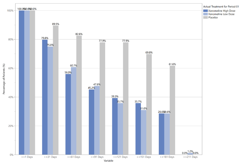

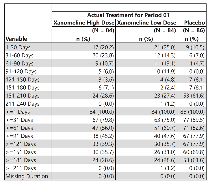

A display of the frequency and percentage of patients achieving exposure milestones according to user-defined individual and cumulative categories are provided in graphical (Figures 4) and tabular (Figure 5) displays.
Figure 4. Bar chart of cumulative categories for duration of exposureFigure 4. Bar chart of cumulative categories for duration of exposure
Figure 5. Table of individual and cumulative categories for duration of exposureFigure 5. Table of individual and cumulative categories for duration of exposure

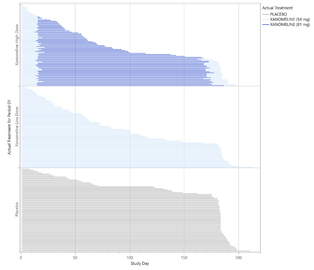

Perhaps most importantly, a swimmer plot (Figure 6) provides insight into notable trends by treatment arm with the ability to gain more detailed insight into individual patients. Figure 6 communicates the patient treatment journey, sorting individual patients by the duration of their follow up. The plot clearly demonstrates that high dose patients began the study on low dose xanomeline (54 mg), switching to the high dose (81 mg) at approximately two weeks into the trial. For those high dose patients who remained in the study, they returned to the low dose at approximately 24 weeks to complete their final two weeks of treatment. What is notable is the variability present in these treatment changes, especially for the later treatment switch. This information can certainly be used to improve scheduling of these key visits in future trials to ensure that high dose patients achieve the ideal 22 weeks of dosing at 81 mg.
Figure 6. Swimmer plot of treatment exposureFigure 6. Swimmer plot of treatment exposureFigure 6. Swimmer plot of treatment exposure

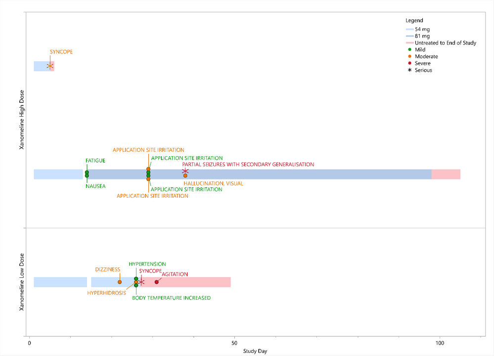

Though gaps are visible in swimmer plots such as Figure 6, they become much more visible in the annotated swimmer plot view, which activates whenever the swimmer plot is filtered to 50 patients or fewer (Figure 7). Figure 7 summarizes the treatment exposure for the 14 Nicardipine and 4 Placebo patients who have at least one treatment gap (one patient on Placebo has two gaps). The maximum treatment gap for Nicardipine and Placebo, is seven and three days, respectively.
But what are the annotations? Figure 7 has markers that communicate changes in doses, which are useful in scenarios where the number of doses may vary substantially within a given treatment. In practice, the swimmer plot communicates at most three doses for up to three different treatments. If there are too many treatments (four or more) or too many doses, the ability to use color to effectively communicate treatment or dosing changes becomes too complex. In this trial, treatments were supplied intravenously, so delays in changing IV bags can impact the dose patients receive on any given day. Hovering over each symbol communicates this dose. To interpret the plot below more generally, these 18 patients had at least one treatment gap, and the doses changed each and every time a marker is present.
Figure 7. Annotated swimmer plot of treatment exposureFigure 7. Annotated swimmer plot of treatment exposure

For example, Figure 8 shows a swimmer plot annotated with adverse event (AE) data for the three patients experiencing serious adverse events (SAEs) in the CDISC Pilot Study. For the first and third patient, treatment was ended at the time an SAE occurred, while the second patient experienced fatigue and nausea AEs when the high dose of xanomeline began around day 14.
Figure 8. AE annotated swimmer plot of treatment exposureFigure 8. AE annotated swimmer plot of treatment exposure

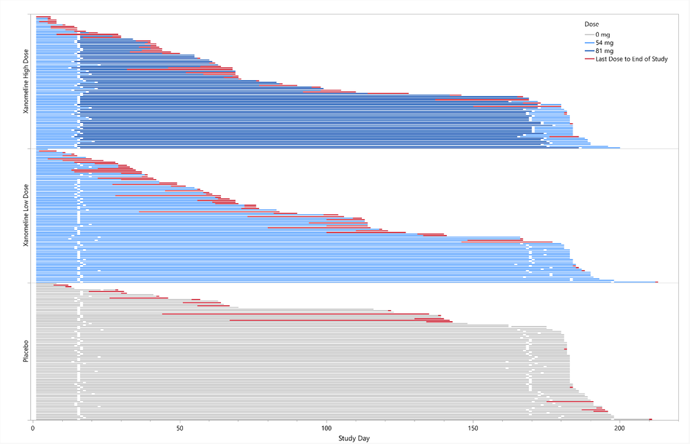

One final important point. Note that the treatment gap definition does not consider the situation where patients end their treatment early prior to the completion of the treatment phase. This phenomenon is more common now that regulatory agencies want sponsors to keep patients in the study even if they discontinue study medications. Summarizing the time period a treatment is discontinued requires CDISC variables that communicate the start and end of study periods, which are often not provided (the start and end of treatments for each period are always provided). For example, Figure 9 reproduces Figure 6 with the addition of red lines to highlight the period of time patients remained in the clinical trial and did not take drug. This red line is a separate phenomenon than the “treatment gap,” which is defined between the first and last doses. Getting regular access to period start and stop dates (ADSL.APxxSDT/M and ADSL.APxxEDT/M) will make it possible to define this discontinuation period more easily. As Figure 9 shows, many patients may continue to participate in the clinical trial without taking any treatment.
Figure 9. Swimmer plot illustrating treatment discontinuation while remaining on studyFigure 9. Swimmer plot illustrating treatment discontinuation while remaining on study
What are the white gaps in Figure 9? This was an early attempt of producing a swimmer plot for JMP Clinical. It illustrates how separate dosing records can create the appearance of treatment gaps, even when treatment is taken every day and the dose does not change. Though these gaps can be informative for showing the variability in kit switches for all treatment arms (where are still discernable in Figure 6 for the high dose arm due to the change in actual dose), JMP Clinical currently removes these artifacts so that they are not confused with true gaps in treatment.
