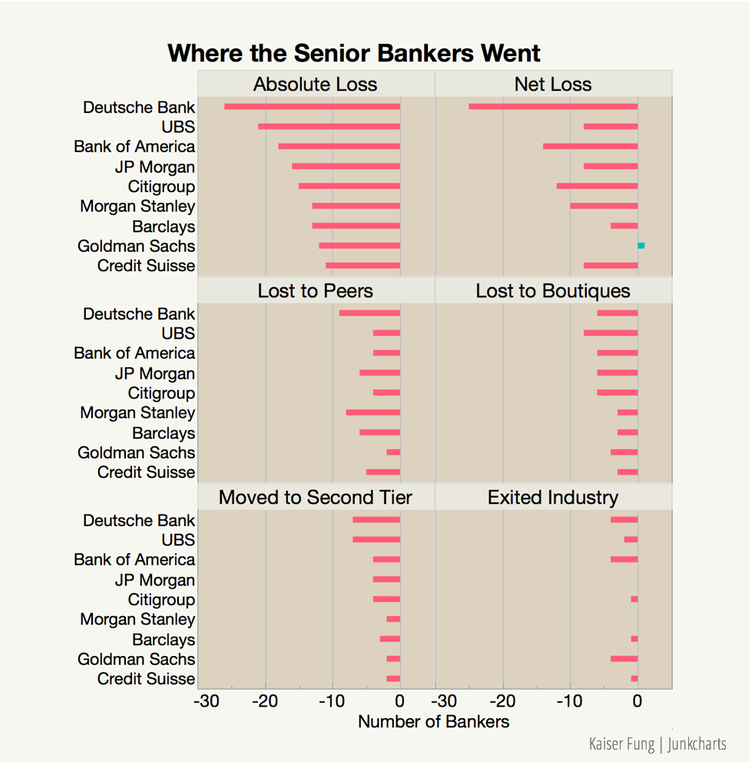

In rethinking the visualization, one needs to clarify the intent of the chart. I decided to switch the layering structure: each plot now shows a different metric used to compare the nine top-tier banks. This reflects the expectation that readers are more interested in comparing across banks than within a specific bank.
Here is a quick sketch using JMP Graph Builder:

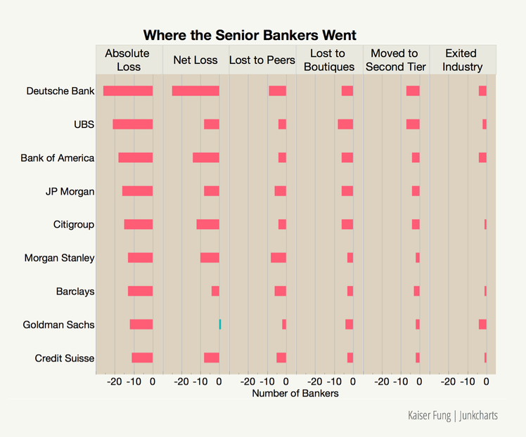

The last decision I made before arriving at the above sketch is the grid layout. I originally made a 1-by-6 layout but ultimately chose the 3-by-2 layout. The former asks readers to absorb six metrics and nine banks all at once, while the latter stages the presentation so that readers can hold just two metrics in their heads at any time.
Here is the 1-by-6 layout:
Designers should recognize that readers have no prior engagement with the data set. After spending hours, if not days, with a data set, we lose the perspective of someone examining the data for the first time. The key is to break down the complexity.
