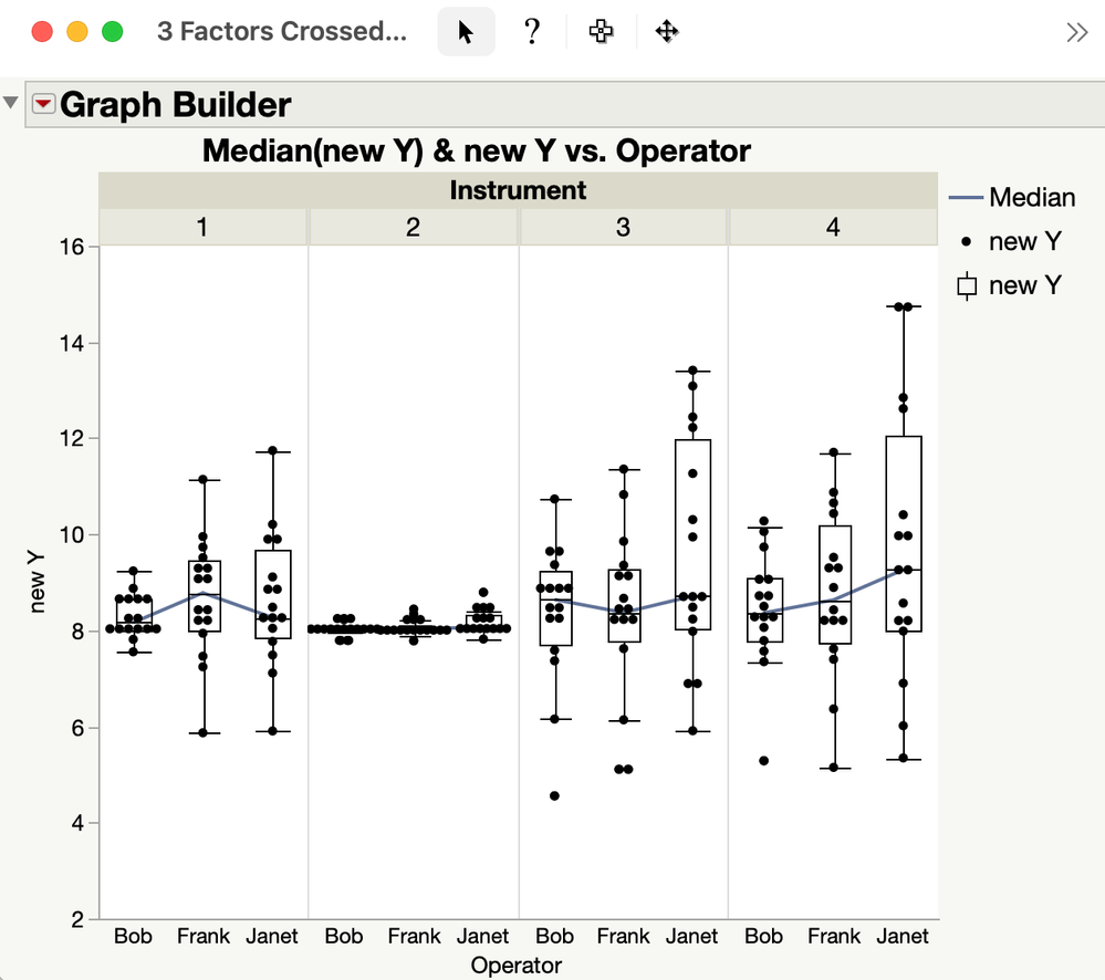

Thank you for the suggestion.   Can you describe a situation where this is needed.  We understand that robust measure  may provide a better understanding of the center of the data, but we want to understand the use case better.
Also, you can create a more customized variability chart. view using Graph Builder, and you could use the median as the summary statistic for the Line element in the plot
