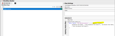

Workflow did not show the correct scripts to delete columns which are referenced to another columns. The alert is confusing as well.
Currently, Workflow in JMP 17 only record "Delete Columns" but not full script to "Delete Columns" which referenced to another columns.

1) Alert  "cannot delete the selected columns while..." should add something like "
2) Improve workflow script to record choices chosen by user (Delete Formula --> Then Delete Columns)
