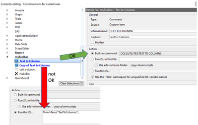

Along the idea of @shampton82 , I have several toolbars with shortcuts to make functions easier accessible which are otherwise hidden deep in the Cols and Rows menus.
To share the Shortcuts with my colleagues, I generated some Add-Ins which can be installed very conveniently.
So far so good.
Now let's come to the problem:

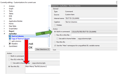

Up to now, I use a JSL function to call the Command via Main Menu or to send a message to the data table.
But unfortunately, this way, the command will not show up in the Advanced log, nor is it recorded by the Workflow Builder.
Is there a way to directly reference the Built-In command in the Add-In?
(green arrow, instead of red arrow)

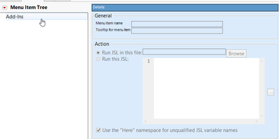

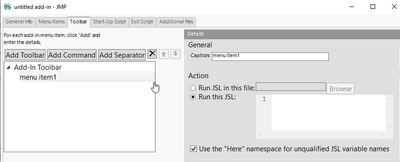

In the Add-In Builder there is no option to do so:

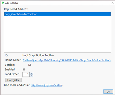

Neither is there an option in the Add-In Manager:

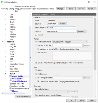

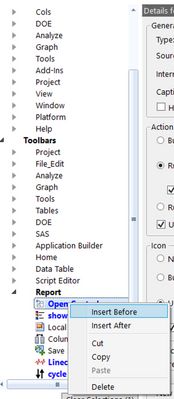

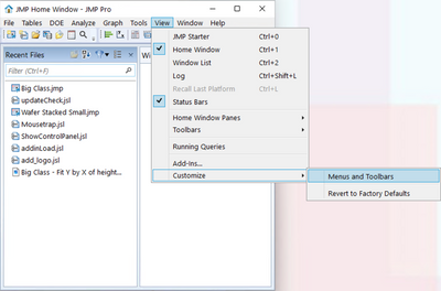

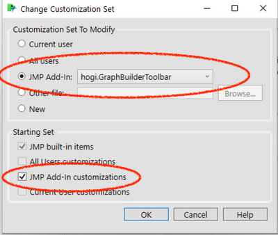

The easiest way to do this is to create and install your add-in as you are currently doing.
Then, go to View->Customize->Menus and Toolbars...
Then choose your add-in and set the starting set to JMP Add-in customizations.
Then you can add your new buttons using the built-in commands.
After you've added your buttons, click Save (at the top) and OK (at the bottom) to close the dialog.
Your installed add-in now has your new toolbar items.

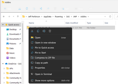

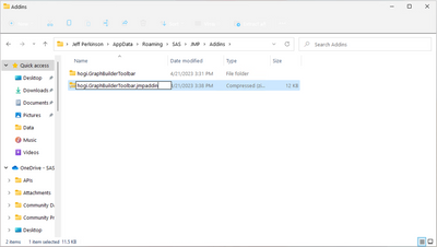

To package it back up to give to someone else you need to go to the installed add-in home folder and zip the folder up and rename it.
Go to the View->Add Ins... menu and select your add-in and click the blue link to open the Home Folder.
Then go up one folder to the Addins folder and right click on the folder for your add-in and choose Compress to Zip file.
After the file is compressed change the extension from .zip to .jmpaddin and you're all set.
