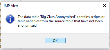

When creating anonymized data table remove all properties which cannot be anonymized
What inspired this wish list request?
Creating anonymized datasets and still having non-anonymized data.
What is the improvement you would like to see?
When user anonymizes data table this error message should give option to remove the scripts and variables, not just inform user about them (or I'm not really sure why they are even left there, the dataset is anonymized, they won't work anyway).
Why is this idea important?
Makes it less likely to share non-wanted data "hidden" in table scripts/variables.

Good suggestion, thank you @jthi
