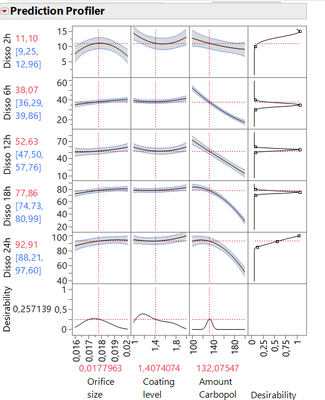

@Charlie i would have a workaround for this problem
Do a DOE for each run, one particular batch, different columns would be the dissolution at different time point with specifications, the data set should look like that:
Do a model using the fit model an use maximize desirability function
In such you will find the best combination of your factors that will set your dissolution curve on target. Would that help?
