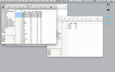

When you Concatenate multiple Data Tables through GUI, a script to reproduce this operation will be created as a Data Table Script.
When you Update a Data Table with data from another, no such script is left.
I want one.

Tables->Update puts a Source script in the original data table. Can you clarify exactly where you're not seeing this script?

This is what I wanted. And it seems it has always been there. Thank you very much! I hope someone else will find this helpful...

Thanks for confirming. I'll close this as already offered.
