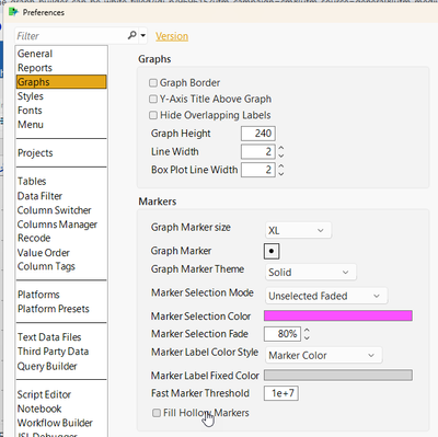

@lehaofeng , the setting can be changed via Fill hollow markers in the Preferences:
unfortunately, the setting can only be changed globally - not by graph.

The setting can be changed via the “Fill hollow markers” option in Preferences, as mentioned in the first post, but it can only be changed globally—not on a per-graph basis. I hope this can be changed in the graph builder.
