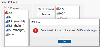

with the possibility to directly combine the results into one data table the user doesn't need to:
- concatenate the different data tables - leading to too many "labelling column"
- stack the different labelling columns - leding to rows with empty labels
- get rid of of rows with empty labels
... saving him/her from some additional issues on the way:
