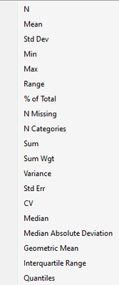

... plus some of the aggregations that can be found in the Summary Table menu
 (at least: N, mean, median, min, max, sum)

I believe you already have those options if you join the tables using Query Builder instead of Tables-Join.
