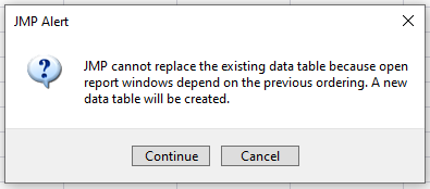

If reports are open, Jmp is not able to sort a data table:
https://community.jmp.com/t5/Discussions/How-to-update-table-after-sorting/m-p/659014/highlight/true...

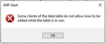

Same issue for data tables with linked subsets: sorting and concatenating data to the data table doesn't work.
Similar issue if a user wants to add rows to a data table .
linked subset:
sort → no
add rows → no
concatenate → no
open report:
sort → no
add rows → yes
concatenate → yes

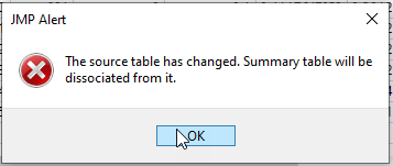

e.g. "cut the link", like it's done for linked summary tables:
sort → no [why does SORT not "cut the link"?!?]
add rows → yes²
concatenate → yes²
² JMP automatically cuts the link:
