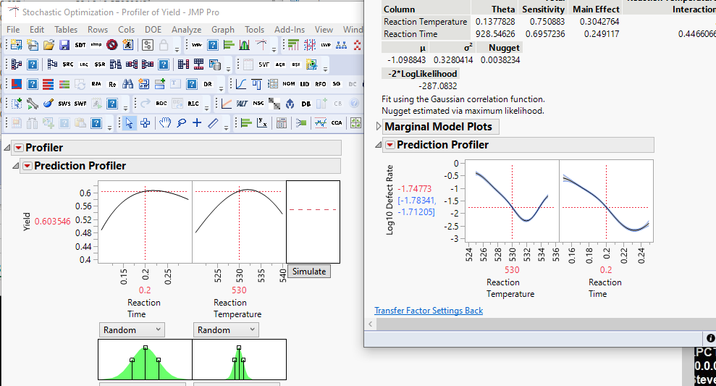

For question 1, here you can see i reordered the main analysis profiler but when I run the simulation experiment(SE) the profiler is in the normal ordering.  In this case it's not a big deal as there are only two factors but when there are a bunch this makes it get harder to switch back and forth between the platforms.

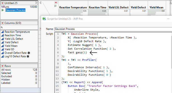

For question 2, I have to type this in each time I run the simulation experiment(SE) as fast gasp wont default on for the standard 128 runs by default.
Ideally if you have JMP Pro Fast Gasp could always be on by default in the SE.

@shampton82 please contact JMP Technical Support regarding the Fast Gasp issue, if you have not already, so we can investigate this. I am not seeing the same behavior that you describe. You can mention this post and that will allow us to keep the tech support case linked to it.
There is a semi-complicated workaround for the factor ordering is to capture the script for the first profiler that you re-ordered, and copy the "Reorder X Variables()" message, and then use that in subsequent profiler scripts.   We are considering ways we can improve the user interface and user experience for the profilers, and we will add this to the list of issues we may try to address.

@shampton82 thank you for the follow-up with technical support.  We will look into the idea of enabling Fast GASP by default in the script that is saved to the data table in a Simulation Experiment that you can create using the Profiler simulator.
