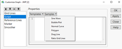

Not sure if this is already possible, but it would be really neat if there was the ability to save graph builder scripts (in the 'customize graph' dialog) in the 'templates' or 'samples' drop-down lists for easier/faster loading during future analyses.

hi Sarah, how does it work?
the Templates menu still looks like before:

Hi @hogi, just to clarify—no changes were made to the templates menu dialog. The reproducibility improvements in Workflow Builder were intended to address the original concern, which is why the request status was updated.

hi @Sarah-Sylvestre , which "original concern"?
