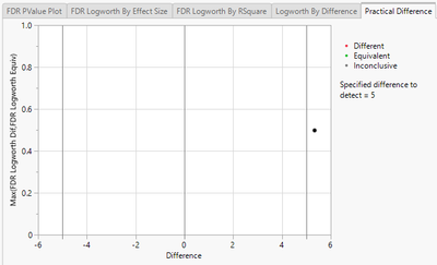

The new response screener interface is much improved for JMP 17, great job JMP team.  I was hoping that for the next dot release you could add in the lower and upper 90% CI's in the equivalence testing out put table as well as the "save means differences" table.  It would also be nice to see the CI's on the this plot
Thanks for considering this request.
Steve

Hi @shampton82 , in JMP 18 B-Y (Benjamini-Yekutieli) FDR adjusted confidence limits have been added to the means differences reports.
