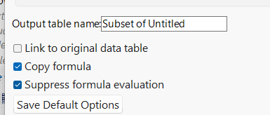

What is the improvement you would like to see?
Something like the options in Tables/Subset:
At least: there should be a warning message like:
you are using column formulas with reference to other rows. It's very likely that the result of this Query Builder is wrong. Please take case to disable the formulas - or remove them.
