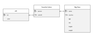

I would like to see a platform which I could easily use to work with Virtual-Joins (and maybe even with basic table operations). I'm fairly sure for this to work great, it would require its own larger platform like Below is a quick example built with Visio.
in JMP if I want to do something like this, I think currently my best option is to use full-joins as virtual-joins are very very difficult to manage in my opinion. I will post a bit better demonstration in few weeks when I can share one data I have been working on, it has more tables and better model.

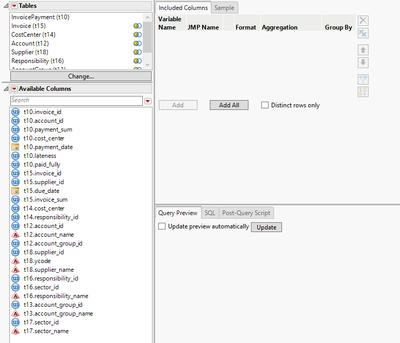

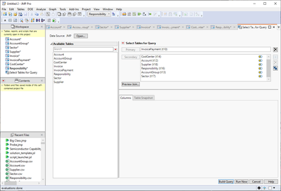

Now I can share the data and model I have as the project deadline has passed. I'm not sure how Query Builder will perform the auto-joins but in my case it does work quite nicely as I have fairly OK data model already built with matching column names. In this example I'm using Projects as it will contain all the tables into that single Project.
First thing I noticed you have to be very careful to have correct Primary table before you start adding anything else, or the auto-joins will mess up. Next I would like to have an option to join the tables by using Virtual-join instead of creating massive table as I usually work with a lot of data and I try to avoid duplicating (at least character data) when ever possible.
Also trying to manage the column list from Available Columns can be quite difficult in my opinion (trying to work with those t10,t15 and so on) so maybe some sort of option to hide/delete/combine "duplicated" columns somehow could work (especially if they are used as primary/foreign keys for joins)
I still think JMP could benefit from visual query building platform but I think I can get somewhere by using Query Builder (especially if it could create and manage virtual joins).

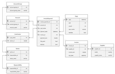

Here is the snowflake schema I tried to model this data with (no Date table in JMP "model"):

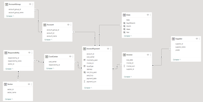

And here is how it does look like in PowerBI (it was a requirement to use PowerBI in this project):
The data I have used here is freely available (besides my own modifications to it) and if there is a need for it I can share it with developers (and most likely also the PowerBI file and powerpoint presentation if needed).
