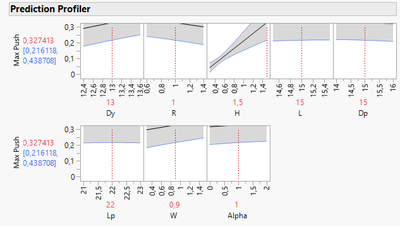

I have a problem with the scale of the prediction profiler. The scale of "H" should be between 0.3 and 0.7. Suddenly it moves its target to 1.5 when I remove "h".

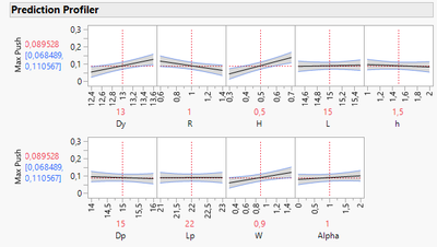

The problem happens when I remove "h". Before "h" was removed, the profiler was "normal".
The profiler seems to get confused by "h" and "H".
