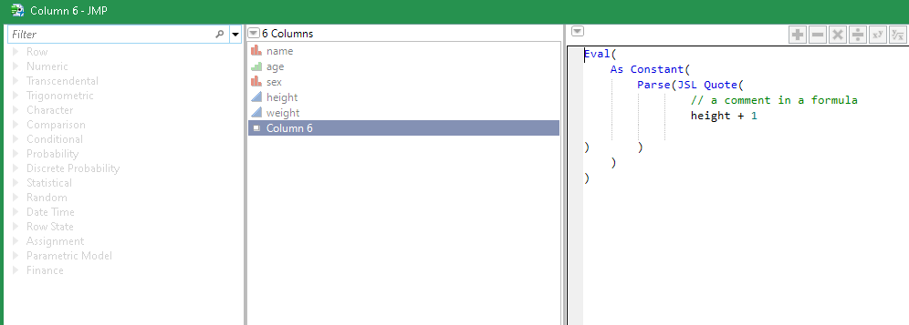

Craige_Hales
This sticks, but is very clumsy to write.This sticks, but is very clumsy to write.

@mia_stephens I would love to say that this is mission critical to the very fiber of my being, but it's more on the high annoyance list. Seems to me from a "jsl perspective" saving the comments should be easy. Clearly the implementation into formulas isn't a complete drag/drop, so I'm ok if this isn't top of mind. I am the only one at my company who I've noticed has really complained.
I also have a work around or two..... @Craige_Hales That also looks like an even better work around, especially if i want to maintain, but comment out print/show commands. My way was just creating a variable that I didn't use but had a string for the long comment i may want to make.
