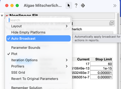

If you hold the control key when you click "Go", it broadcasts that to all the By groups.
MathStatChem
Level VII
There is also an "Auto Broadcast" command on the top level outline that will do this for you also.
Hello @JMPinthePool , did you try the broadcast option by holding the control key and click the "go" button, or using the "broadcast" option in the red triangle. Is that helping what you are asking for?

@Valerie_Nedbal @MathStatChem Thank you so much for pointing that out!
But it doesn't solve the situation where i would like to apply the same bounds to all By groups, or where a matrix summary of all fits like you get in the Fit Curve platform would be useful?

@JMPinthePool I agree that the "fitting many curves" problem is hard to do with Nonlinear, unless you resort to using JSL to automate much of the repeated settings.
