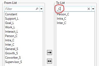

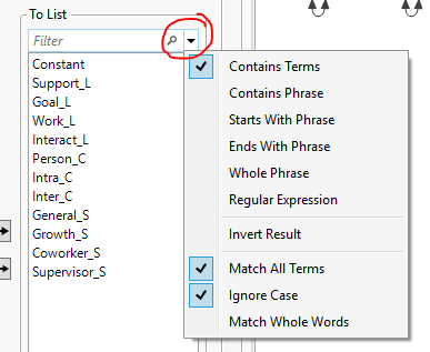

Hi Narayanan,
Might you be able to list a small subset of variable names that illustrate the complexity so I can understand the issue a bit better? The filter has a number of cool features that can be found by clicking on the little black arrow next to the filter box.
You can even use regular expressions, which enables filtering in elegant ways. However, I understand that if variables aren't named according to factor groupings, this can be complicated. An example of a subset of variables names would help me here to think of a good solution for you.
In this example below, because the sample data table Job Satisfaction.jmp has suffixes for the "Conflict" variables (_C), I can use that in the filter, which then facilitates the selection of these items to create the latent variable:
