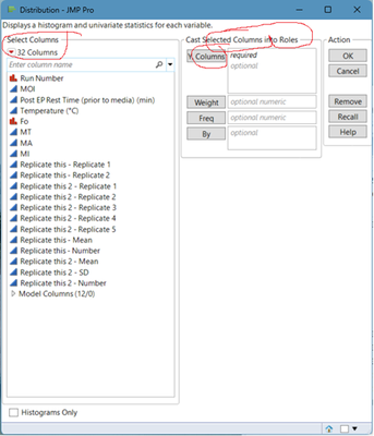

The user interface in JMP has trained me to select columns and drag those to boxes, including the formula editor.  In the background those Col List Boxes generate strings that correspond to column names, but that is not how the dialogs present things., i'm dragging columns around.
