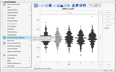

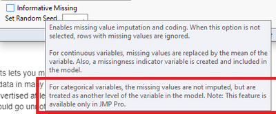

I think most of the platforms in JMP should support this in some way (not just Process Screening). For example Graph Builder already does and so does Neural Network when using JMP Pro.
Graph Builder has option to treat missing as separate category
And Neural Network can do same (with JMP Pro)
