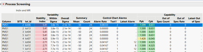

Say you do the following, slightly modified from the scripting index:
Names Default To Here( 1 );
dt = Open( "$SAMPLE_DATA/Semiconductor Capability.jmp" );
obj = dt << Process Screening( Grouping( :Site, :lot_id ), Process Variables( Eval( 5 :: 132 ) ), automaticrecalc(1) );
You'll get a report like this with rows for the different combinations of values from the Grouping() columns:
And those rows act as a gateway to various plots.  For example,  you can get Process Capability or Control Charts that are pretty much as if you had used these grouping() columns as a By() on those platforms.  But you won't get a row for a grouping where any of the Grouping column values were missing or, if character, whitespace.  So if you replace a lot_id value with blank or a SITE with missing you don't see that appear on the report so you don't know there was some data that was like that, maybe needing attention.
When I discussed this with JMP support I was told that this is consistent with other JMP platforms, for example how X values that are blank don't show up on the X axis of a Oneway.  But my perspective is that Grouping() is a lot more like a By() in this case (which does make plots for the by groups with values of missing or blank).  The situation with Grouping() is also similar to summary/summarize which would recognize those groups and produce a row.
I appreciate that Process Screening has a By() and Grouping() is not it, but I think there would be value in showing up these groups and providing access to the same plots you'd see from a by()  (ie if you ran Control Chart() with a by() on the same columns you would see a report for a missing SITE):
The upshot is that I was encouraged to after all make a Wish List item on this so this perspective could be considered.
I think it would at least be worthwhile as an option.
