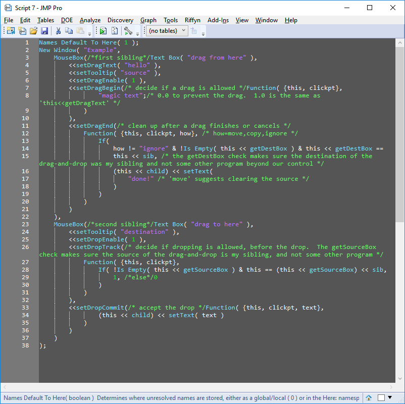

I have gone through and created dark theme that looks like this:
Unfortunately, the downside to this theme is that the blinking text cursor is still black and can be difficult to see.
I have attached the JMPStyles.PFS file for this theme. You can place this file at "%AppData%\Roaming\SAS\JMP\14" on Windows to apply the theme after restarting JMP.
However, I realize this is not a perfect solution and I will pass this along to our development team for review for a future release of JMP.

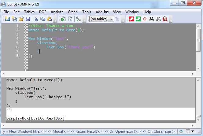

 Wow Thanks!  I do look forward to a smoother solution in the future, but this makes me and my eyes super happy!  My colors are slightly different, but that's probably b/c I'm on JMP 13 still (or maybe windows 7?).  B/c of this it's not hard to see the cursor at all since this grey is much lighter.  But if themes are included in the future, lets be sure to change the cursor color as well!
I copied the code where applicate for the Log, but wasn't sure what to do for the values: Log Submit, Log Output, Log Output Start, Log Output End, or Call Tip?  This isn't important, I really appreciate your feedback.
Thanks for setting things straight, Justin!  This is a really nice color scheme.

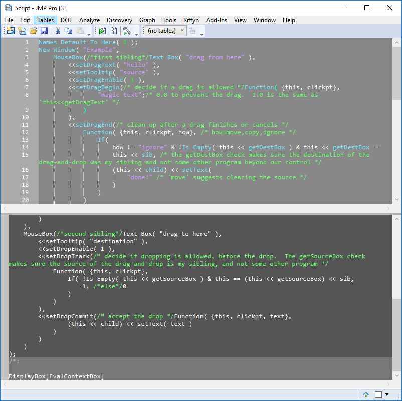

Check out my updated post above. I have added colors for a decent looking log.
Here's a screenshot of what it looks like on my computer:
This also works on Mac. Go -> Go to Folder -> ~/Library/JMP/14. Then you can add-in that JMPStyles.PFS file that Justin has above.
