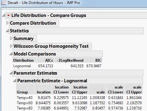

In Life Distribution - Compare Groups show comparison of Lognormal T50 (Median) parameter estimates
When comparing groups in Life Distribution for the Lognormal Distribution, it would be great if T50 (Median) values were shown in the comparison table, as they are more intuitive than the location values that they're derived from.
When using the Weibull for the same application, this is already the case. There alpha and beta are reported instead of location and scale.
Maybe the same kind of parameter sets could be used and alternative ones provided optionally via right-click -> Columns.
