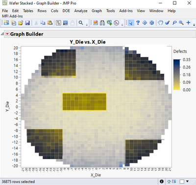

I have few suggestions regarding Fill Selection Mode in JMP graphs to make JMP visuals provide more information quicker. There are a lot of different situations where JMPs default option of Selected Patterned isn't really that helpful. I will use Wafer Stacked.jmp as an example dataset for most of these with this starting situation (stacked wafermaps and Defects mean used as color) and I have selected some random areas. There are a lot of other situations where diffee
Not very easy to see QUICKLY what has been selected if I'm using default option "Selected Patterned".

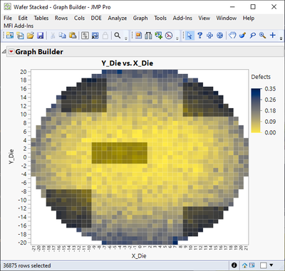

Selected Darkened

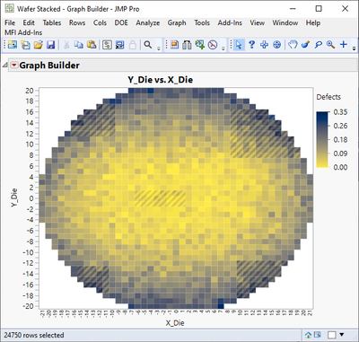

Unselected Faded (best for this case in my opinion with current options)

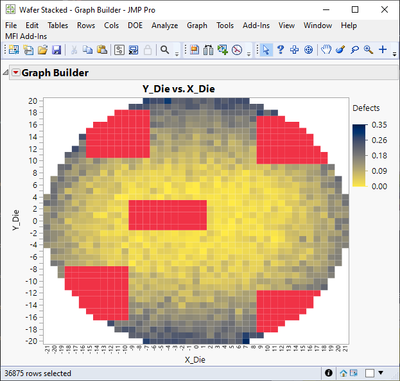

And finally Selected Same Color (otherwise good but it is difficult to change the color AND I will lose information on the graph, so I wouldn't use this in this case)
But what I would like to do is to combine these (at minimum two) or at least have few new options. I would like to combine at least Selected Outlined+Unselected Faded or Selected Darkened + Unselected Faded.

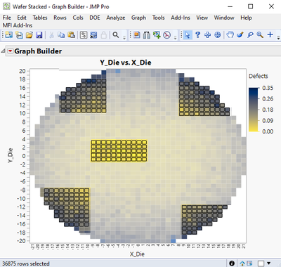

Demonstration of Selected Outlined + Unselected Faded
And in this case maybe better option Selected Darkened + Unselected Faded

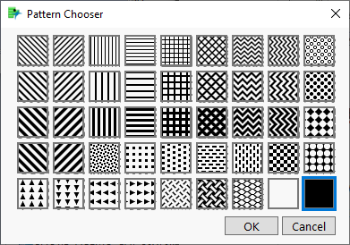

4. Maybe nice to have in some cases let us define which Pattern to use when using Selected Patterned
Sometimes different pattern could solve a lot of visual issues. We do have a lot of different patterns already available, they are just "never" used
